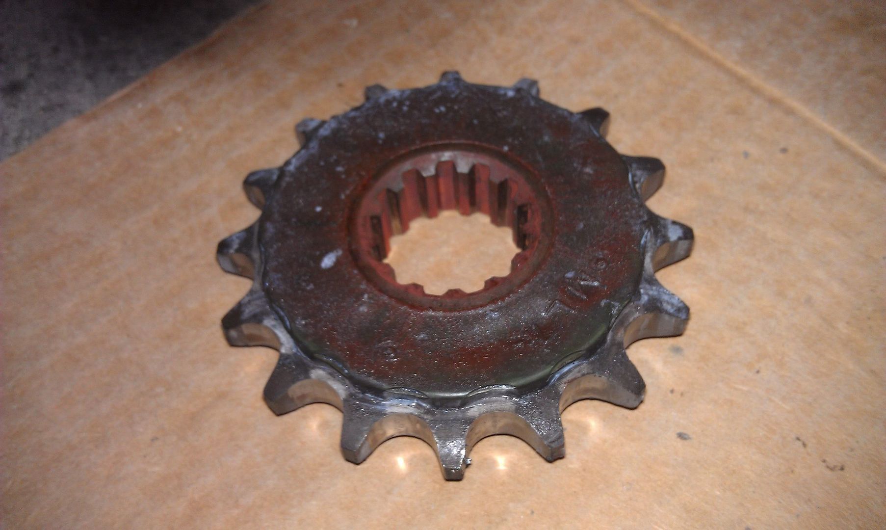

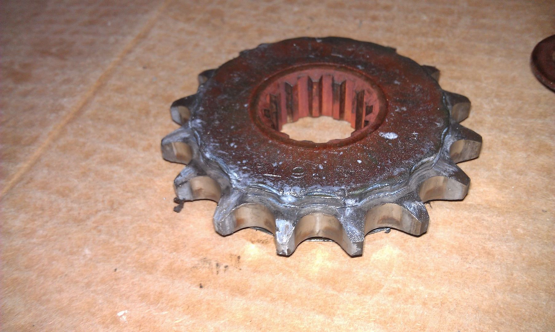

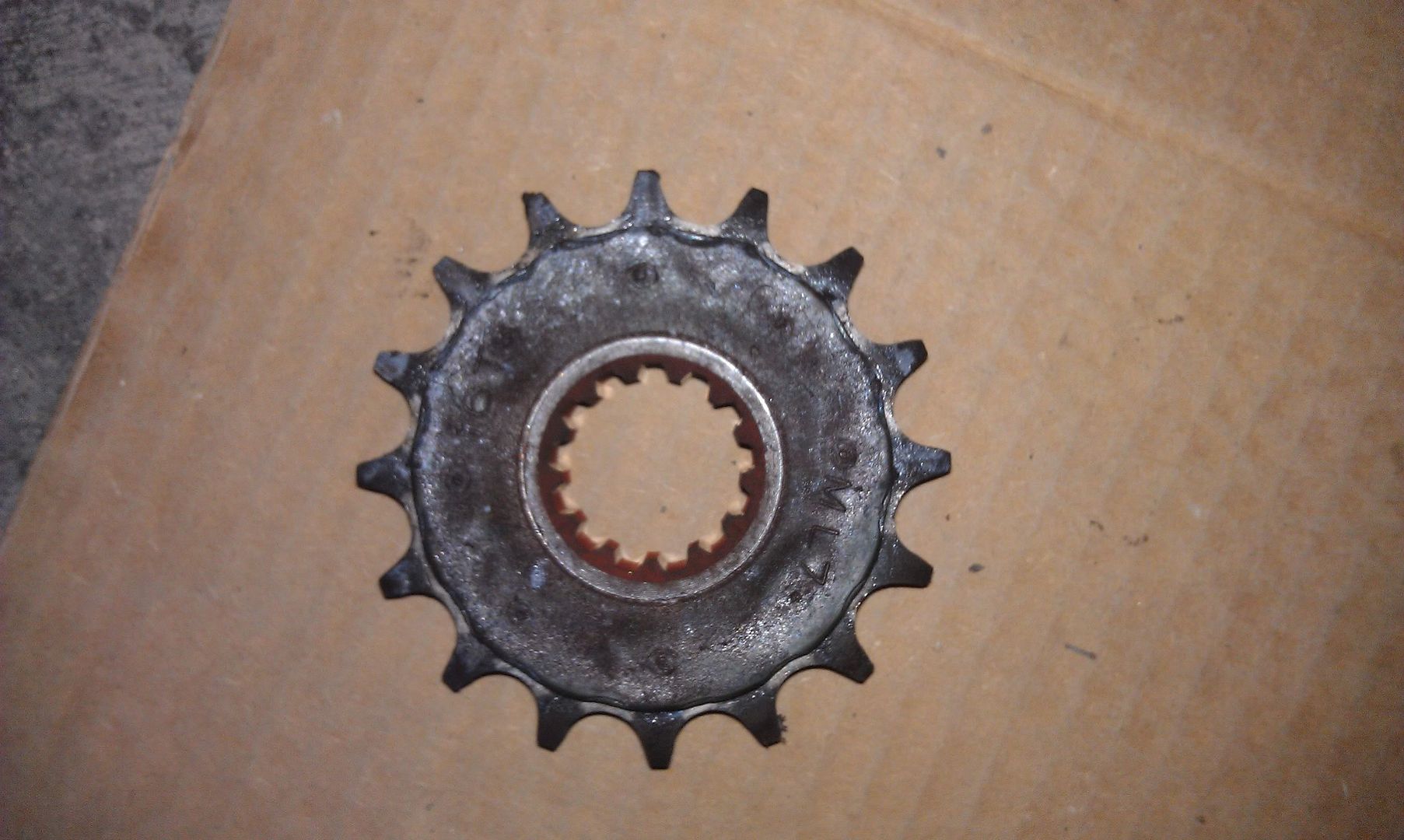

I took off the front sprocket and ran it through first. The noise was very quietly audible. Given I just took alot of rotating mass off the driveline, I idled it in 5th and shot a new video. It's pretty loud. A local bike tech of Godly levels here said from what he could tell just from my vid, it sounds somewhat normal. He said he's ran them on stands before and gotten some noise. Also, went on to explain if it was a chipped gear tooth or just about anything wrong in the internal crankcase, I'd definitely feel/hear it on the streets and most likely in one single gear, rather than all. As I said before, I was doing some crazy speeds just before I first noticed the clunk when starting out from a stop. I didn't feel or hear anything out of place outside of that... which once again, I highly assumed was my loose chain.
Here's the vid I just took, along with pics of my front sprocket, just for good measure.
