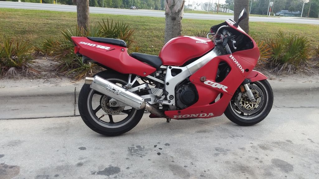

New to the forum and just picked up a 98 900rr.
Things the bike needs now......
1: Rear brake lever mount is busted.... Will add pic
and would like to know the best place to pick one up.
2: No front turn signals. I'm not sure why but it looks like it had flush mounts at one time. The rear signals still work. Ill add pics so you can see. I would also like to know the best site to pick some up.
3. No tag lights at all. I thought about just buying a short LED strip and tapping into the running lights.
4: When at idle and deceleration I have a popping sound like It's running to rich or lean. It does have a Vance and Hines pipe but I'm not sure it was tuned at they had it installed. I'll add video after I upload to YouTube.
Thanks and all help is greatly appreciated.

One more thing, I don't know if you know, but the first picture has the bike sitting really low. Did you know the triple clamp is like 2" lower than stock? Looks like the rear as well. FYI only really.
