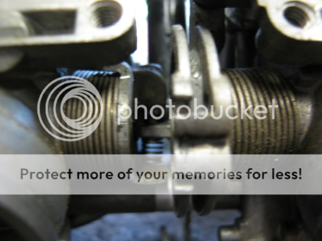

My suggestion is to get a manual, buy new o-rings, separate the carbs and replace the o-rings yourself. That will save you hundreds of dollars in unnecessary costs. It's a myth about the sync being hard to adjust, and even if it did need adjusting it would still cost you far less to have a reputable shop do it for you if you do the o-rings yourself. I had move broken down twice last year, and the sync was barely out.
Just take pictures before you start for reference. The hardest part is remembering where the small springs go, like the small one in the middle here:
