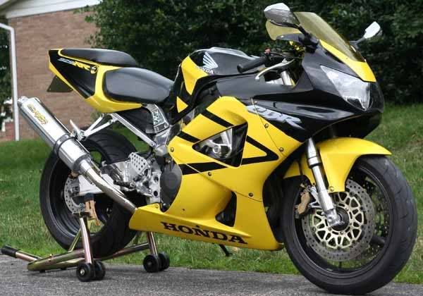

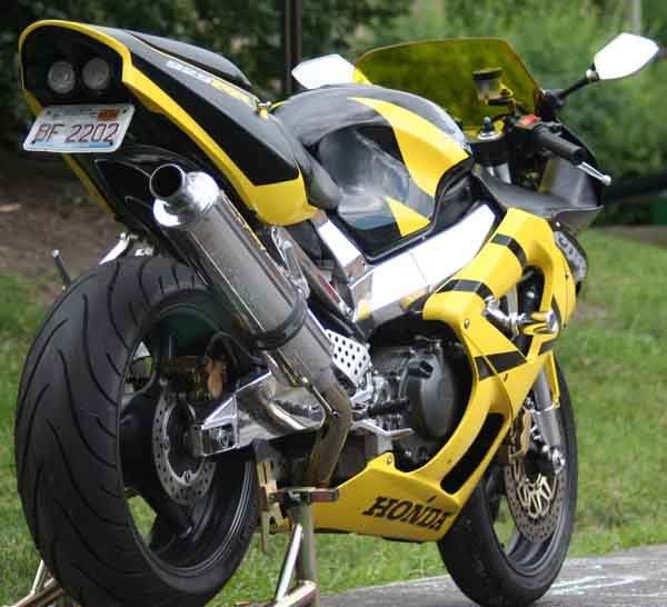

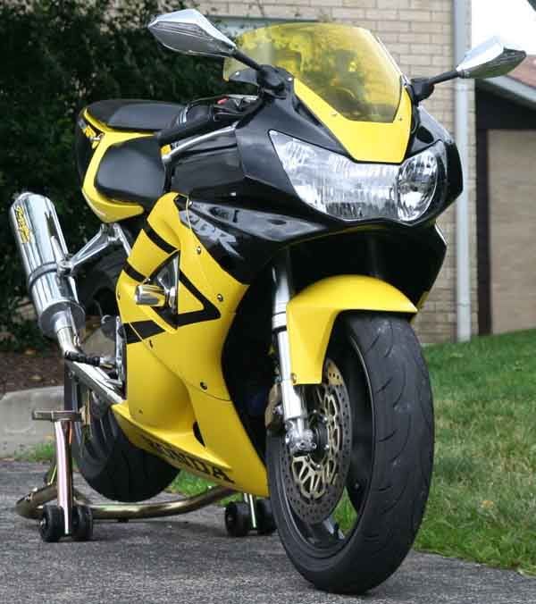

mods: polished frame (if you look closely you can see the reflection of my midpipe in the swingarm), two brothers full exhaust, pcIII, accelerator pump mod for pcIII, gutted airbox (like flapper mod), stock airfilter (had k and n before), led undertail with integrated blinkers, front mirrors with integrated led blinkers, did erv3 chain, stealth +2 rear sprocket, afam front sprocket (stock teeth), yellow windshield, custom padded driver seat, custom cover for rear seat, chrome vortex frame sliders.....
phew and to think I wasn't going to do anything to this bike because it was too good from the factory
planned mods: custom dyno tuned map for power commander

They were 50 or 55 I believe. They also have black ones. It's a universal fit so many bikes use the same one.
The nice thing is that the blinker is at eye level for cars. I can't remember that last time I actually saw a bikes flush front blinkers blinking.
