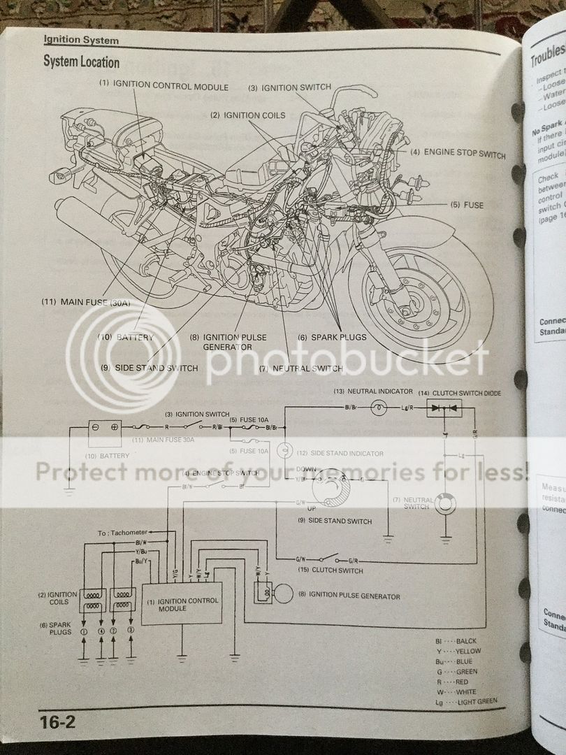

Jumping this switch doesn't always make the bike start if there is another problem associated with it. Check all your grounds on the bike, and test the involved circuits via the service manual's instructions, if you don't have a manual, GET ONE ( but here's a few pics of the starting system and ignition system for your 94). And get a multimeter too, of course that's if you don't already have one. :thumb:

Ignition system:
