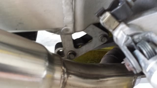

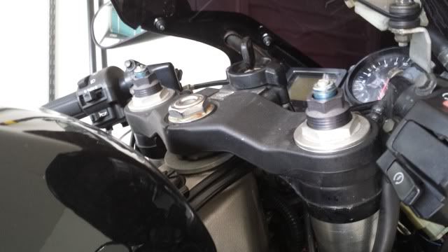

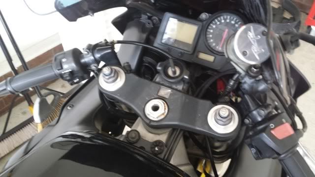

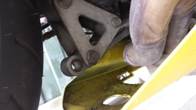

Maybe I should take a picture of the front end so you can see.. Im not quite sure if it was lowered that way as I cant tell the difference.
4,132 Posts
Great idea! Try to get a few different shots of the triple area, and a few close-ins of the dogbone/shock mount area. If the dogbone has multiple holes drilled in it, I can pretty much assure you it is aftermarket/lowered. The forks would be best to view a pic to let you know. The other easier way to tell if they lowered it by dropping everything down the forks is to turn your bars to full lock on both sides. I noticed that every bike I have seen that has been lowered this way will either hit the tank, or come extremely close! I rode one guys 600RR around the yard and noticed how crappy it felt lowered 3", and the bars touching the tank constantly wanted to pinch my hands even when not at full lock. :thumbd:
834 Posts
Added pics to the top, hope it helps
Front is stock and rear is lowered 2" with the lowering link. You can put the rear back to stock by moving the bolt to the front hole on the lowering link or replace it with a stock link.
