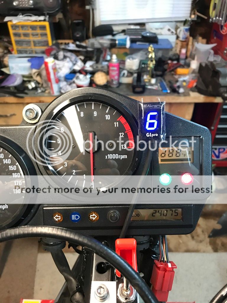

New bit of kit came yesterday for Agent 99. Too bad she's last in line on the schedule:rotfl:
Healtech Gear Position Indicator in Blue::eyebrows::eyebrows::eyebrows:

Here's the limited pics I've got of the Healtech GiPro Shift indicator. Installation was very easy, as the instructions were very clear and easy to follow. It's plug and play with a twist.
They have a harnes that connects right in line on the speed sensor. Easy peasy. BUT, they also have a black/green wire that they want to be connected directly to the tacho (yellow on my RRX) wire coming out of the ECU. They provide one of those press fit plastic clip type junctions.
I don't like those things, so I was able to locate the yellow wire out of the ECU and followed it to the pulse generator 2 pin connector. Sorry for no pics of the spade, but I removed it from the connector and soldered the Healtech supplied black/green right onto the yellow spade, and popped it back into the connector. Lean, clean, and mean :grin
It's not in an ideal location, but it's in plain view and it's not blocking anything. The indicator came with double sided tape on the back and right side. I decided to keep the protective layer on the tape and used some beefy 3m hook and loop stuff just in case I decide to move it. Set up was VERY simple, and quick. Basically ride the bike at double idle speed not exceeding 4K, shifting when it promts you, get to sixth, job done. My street was kinda short to be in 6th gear at 3500rpm so I had to truck it over to Dave's house. Job done!

As you don't need a speedo, one suggestion would be to cover the clock in matt black fablon and stick the gear indicator on that.
Good suggestion! I would expect that as I get (or ever get) track days under my belt, some sort of aftermarket dash will be installed, or I'll do another F4i mod. They're smaller.
But you're right, no need for the speedo dial, with different gearing installed it's already off by a ton.
