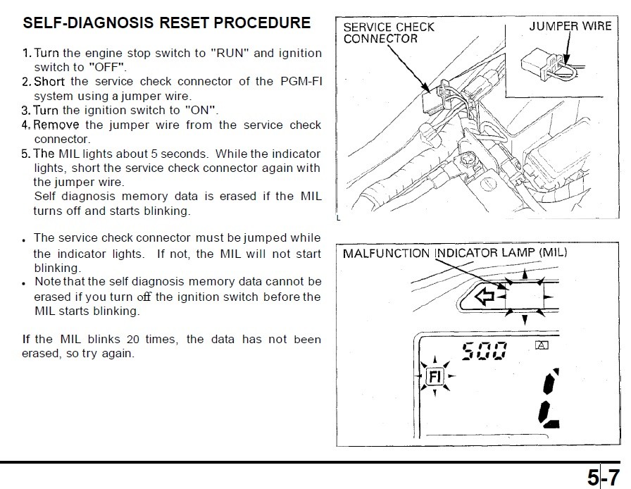

#12 ·
looks like it cleared followed the instructions and the light started blinking non stop and now when i try to jump the service connector to check codes the mil stays red with no blinks. does this mean i have no codes? light goes off if i take the jumper out, turn everything off, turn everything on and start the engine.
